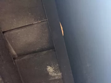

Here's a crappy picture of the inside looking up
[Hearth.com] Trying to identify my stove
CodyR thanks for taking the time to send a picture. I am sure I am not the only one who likes to see how these older stoves are built. They did incorporate the bricks as a heat shield instead of a metal plate. I like the looks of this stove to bad it won't work for you in this situation. But you would be better off with a more efficient wood stove as it will save on firewood and give you a cleaner burn and longer fire.
