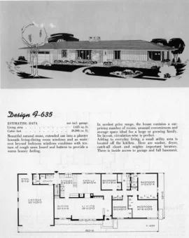

Pictures: my layout is similar to this, but instead of a "family room" it's just a foyer, and there are only three bedrooms (big master is on same side of house as living/dining room, as if you combined the two small bedrooms in the picture). The fireplace is on the wall separating the kitchen from the living room. I might put a wood-burning hearth on the wall separating the living room from the master.

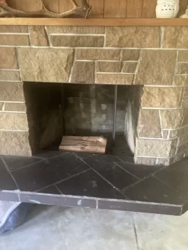

Fireplace with ledge. Ledge is 21 inches deep at the opening. Fireplace opening is 34 x 24; the interior is close to 28 x 28 at the back, 16 inches deep at top, 22 inches deep at the bottom.

The 24" height is a tight one for some inserts. For example, there is the Quadrafire Expedition II, but it is 23 3/4" tall.
