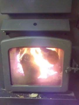

I have 8 inch duct and reduce to 5 inch I try decrease and increase the blower SBI is sending me a new snap disc that cut in at low temp hope that its a faulty one.With my Kuuma I have my low limit button switch placed high up in my bonnet and have it set at 110/90 (put it at 105/85 when it gets very cold). Even with the computer set at minimum burn the blower pretty much runs constantly from the time it turns on till there are a handful of coals. Minimum burn will get me ~95°-100° vent temps. Max burn will get me ~110° vent temps all with the blower running the whole time. I did have to create more positive pressure in my duct though, as I seem to have over-sized ducts which would move too much air too fast not allowing the air to get properly heated. Wonder if this could be an issue as well........?
