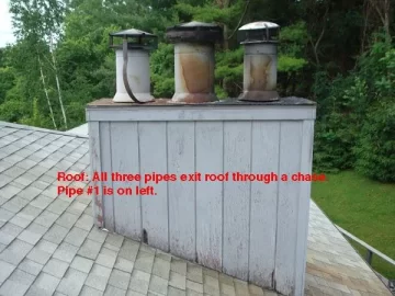

I'm planning to replace a factory-built chimney. Right now there are three chimneys that all exit a chase on the roof at the same height (see attached photo--yes, the chase needs some work too). I keep reading that this can cause problems, and that adjacent chimneys should be at least 3 ft different height. Is this true?
