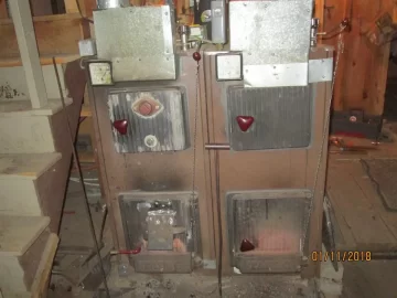

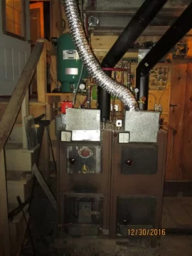

Here is a picture of the front of the old 1979 Tasso boilers. I will get a picture of the busy back side tonight. This picture is from last season when I first tried this two boiler plan, and it was a total fail.

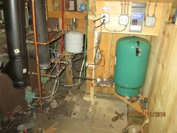

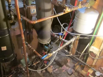

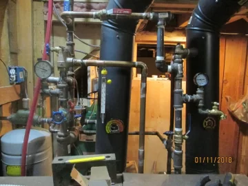

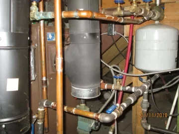

I still plan to replace all the plumbing to larger diameter pipe, after going threw all the trials I decided it was best to keep it simple till I get what works.
One of my questions is would it been better if I had run a loop and just tee'd of the loop to feed each boiler? I think the way it is its dead heading when the W/B circulators are not running and the water is not returning to the OB.
