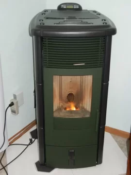

Paint can be a very cheap improver. I have done some minor paint highlights that can really be nice.
I did a forest green front on the Elena

Bioburner, hey I like that! Looks great, reallygreat! I'll do that for sure. How much do you think venting will run?
