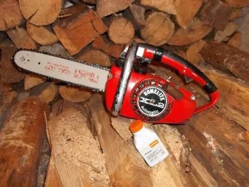

I inherited this small saw , its is mid 70,s vintage . Using Stihl two stroke motor oil what would be the correct oil to gas ratio ? 40/1 , 50/1 ? To be on the safe side I have been running 40/1 but it really smokes !
Most saws regardless of what they originally were are fine running on modern oil at 50:1 but 40:1 is fine. I bet that saw was designed for 32:1 with sae30 oil.
It smokes cause the Carb is not adjusted right or air filter is dirty, or low compression.
The smoke is likely because bar oil is getting into the crankcase via the check valve. Common on vintage saws.
Run the same mix you run in everything else. Follow the mixing instructions on the oil container. For what you have in the picture there that would be 50:1.

I love the wooden starter handle.. I use to use one or two of those for my climbing saws when I first started out... I found them to be cold blooded as moving around in the tree and setting up for another cut , the saw would need to be choked again.. Hated it,,, and also was an unreliable starter...I think they had weak coils!

Well, maybe both Clemson and I were both right. It specs 32:1 but only with Homelite mix oil. Most saws of the time would spec one ratio with that mfgs oil and double the oil with anything else.

It smokes cause the Carb is not adjusted right or air filter is dirty, or low compression, not because there's too much oil in the premixed fuel
