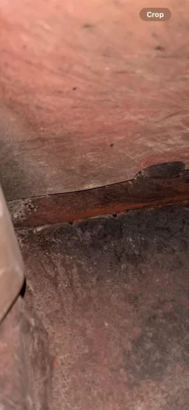

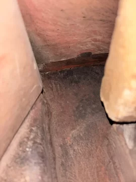

Was poking my head inside the stove today to make sure it looked good prior to burn season, and saw these two tiny holes in the upper LH front cover of the stove. Possible weld burn though? Panel feels solid, not rust. It’s a thick plate of steel. No holes on the other side. Thoughts? What problems would arise from this? I sent Drolet an email with photos asking them also, but curious to see what you guys think here. Stove has only been used for 1.5 winters. Was installed of January of 2024. I have no idea if those holes were there or not when I bought it. Never thought to really look there. Shined a flashlight on the outside and stuck my head in, saw no light protruding into the stove.

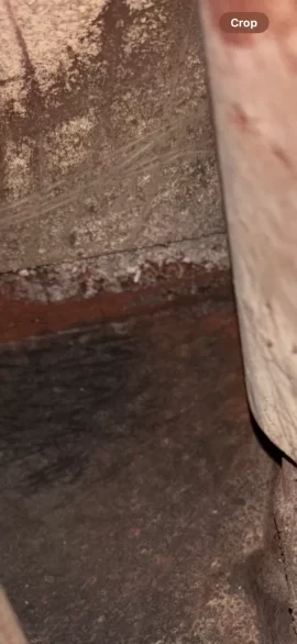

Edit: looked closer and saw what could be at least 1 possibly 2 small matching holes on the other side, but may be clogged with ash/soot/debris. Added photo of other side

*not a professional stove builder opinion*
It does not look like weld burn through.
It does look like a locating notch for assembly, a point that can be referenced while manufacturing, or a random notch left by a CNC cutting program when cutting out parts.
I do use a CNC plasma cutting table daily at work, some of our parts will have a notch that's similar looking. Sometimes it is part of the "lead in" or "pierce" for the torch, sometimes it is a reference mark for fabricating, and sometimes it is just a mark left in the programming that hasn't been modified out. It could even be a reference to the welder as to where to start their weld.
If you can't see light through it, I'd forget that it's there!
Drolet said as long as I can’t see light from the outside in they see no issue, I asked what caused it they simply said “laser cut”
My concern was smoke getting not the void behind that plate, it seems there would be? I don’t see any holes in the welds along the outside in that area, nor any light passing through from the outside to inside
