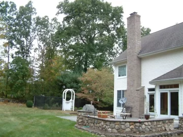

How tall is the chimney? What is the alternative being suggested by the dealer?
[Hearth.com] Ugh, dealer does not want to sell me a CI2600 or Hampton hi400
That is a pic of the chimney. No specific alternate recommended. The whole deal is frustrating. It is a good looking insert, but apparently, not fully trusted yet.
Since the air restriction plate change folks seem to be quite happy with this insert. I would estimate the chimney height at around 25 ft. If so that is not extremely tall. Maybe try another Regency/Hampton dealer?
