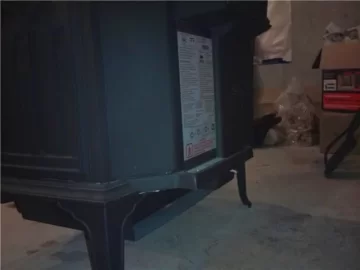

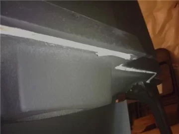

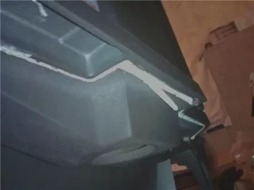

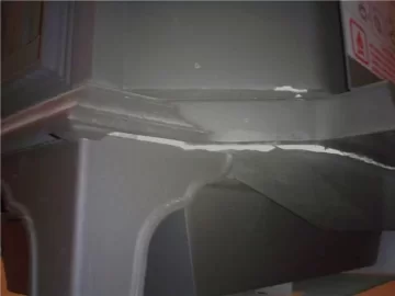

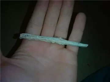

is this just excess cement from manufacturing???? My stove top has only seen 600 once or twice so I think this is just left over junk, please let meknow what you think!

600 degrees is within normal operating temp - so no damage from that. looks like the assembler went heavy on the cement and now the excess is simply falling away. i bought my oslo used - so hopefully some new owners will comment.
Mikepinto65,
It looks to me to be excess cement. I just checked the same location on my Oslo and in comparison it appears as if yours has a lot of excess cement that has "squooze out" from in between the cast plates and has merely fallen off. The "groove" between the plates on mine has almost no cement in it. If you check closely, you will very likely see that the cement seal between the plates is still intact. Personally, I wouldn't worry about 600*. In any case, a couple of runs up to 600* shouldn't harm anything on these stoves. I've seen 600* surface temps on all three of the Jotuls I've owned (see sig. plus a Castine) and never had any damage. My preferred cruising range is in the 400-500* range though and I try not to operate them above 500*. JMO. If you're still concerned after examining the stove, fire it up and see if your normal damper positioning relative to normal firing temps has changed (e.g. are you getting more draft than previously and therefore running hotter).
My new Oslo has similar excess cement in various places. Mine even had a few chunks in the firebox that were obviously just excess from sloppy application that I removed before installation.
