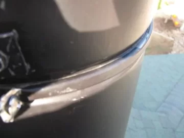

Here are a few more pics. The first is the spot where the water was exiting to the outside of my interior pipe. You can fainltly see two, whitish lines there.
Collar on roof looks very good to me.
Cap is obviously bent, but water is still going to have to defy gravity to get into the pipe.
That band holding two sections together isn't all the way up on the lip. Possibly a problem, though I would be surprised.

Yes, the outside looks ok from what shows in the pics.
Is this Metalbest DSP pipe? If so, that has an innerwall crimp and an outerwall crimp. The finishing band just below the support box is to cover up the outerwall crimp. That doesn't solve your issue, but it would explain the crimp direction.

I made an adjustment to the cap, re-banded the two pipe sections above the roofline, applied silicone caulking to everything,
including a few spliced shingles, and had no leaks after nearly 2" of rain last night.
Yes, I believe the interior pipe is upside down. Waiting for an explanation on that. Don't guess it hurts if I'm not leaking water.
