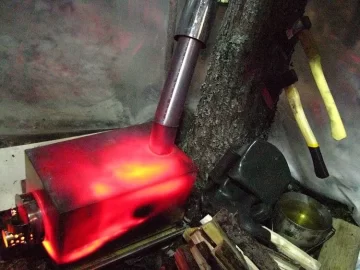

Thank you for the info . It's really hard to pick the right stove ! I've been reading on here and the temps from these new stoves are kind Of scary 600-800 degrees really ! That would burn the trailer down it would seem .
Think that is scary, try 1000F in a small tent.
[Hearth.com] Undecided
You will be fine @600F with a properly installed new stove.
