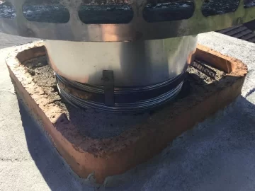

Trying to send some pictures. Not sure if this is going to work

In that first photo it looks like there some loose insulation, maybe there was a miscommunication?

Regarding that little bit of insulation. that was used to help support the concrete that they used to hold the liner in place. It developed a hole in it, which required me to have it removed and a proper s,s. plate instaled. That is how this whole mess was discovered.

Looks like in order to do insulated properly, the clay would need busted out. I have a feeling they realized that on installing, and rather than stopping for further discussion, they just installed what they did and got out.

I am confused with the last photo.
Did they pour concrete around the SS liner or is that vermiculite based insulation?
See that hose clamp a couple feet down? Looks like they had to splice in another piece.

They poured about a inch of concrete to hold the liner from moving. They must have packed some fiberglass insulation around the liner to support the wet cement.
Another problem I see is that concrete they poured forms a bowl, and will fill with water, and eventually leak. Either more needs to be added to form a crown, or you need a properly sized storm collar.

"concrete that they used to hold the liner in place. It developed a hole in it, which required me to have it removed and a proper s,s. plate instaled. That is how this whole mess was discovered."
