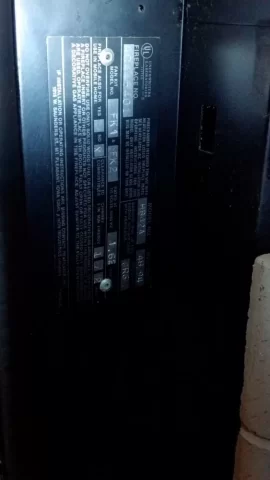

Did you try calling heatilator? That may be a serial # not a model #. Can you post a pic of the tag?

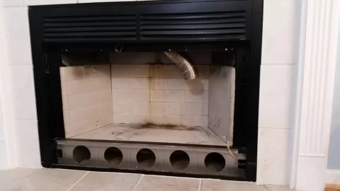

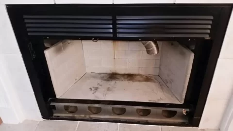

That number I posted was indeed a serial number. I now see the model number above it. Pix included.
I need a source of heat in the winter in case the power goes off, which it does from time to time. I plan on having some sort of LP gas log in it, (suggestions welcome) but I need to be able to remove the gas log and burn wood in it if I have to.
The flex tubing runs all the way to the top of the chimney. I'm going to have to remove it. The bottom grill is missing, and the damper and some of its hardware is missing. I did find a parts list, but I haven't tried to source any of the needed parts yet.
Sooooo. Would it be possible to make this one work (SAFELY) or should I think about some kind of replacement?

There is no option for having a gas log set in a factory built wood burning fireplace and also being able to switch over to wood when you want to.
It is either or. You can install a gas log set in a factory built wood burning fireplace if the fireplace manufacturer allows it. The install manual will tell you whether or not it is approved.
If you then want to go back to wood, you would have to remove the gas line and return the wood burning fireplace to it's original, un modified condition.

Provisions for a gas log set are listed on page 18 of the manual.
