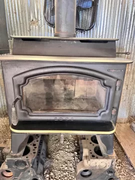

Greetings! I found a listing for a 1994 Lopi Liberty, labeled Model 520-NT. This is a non-catalytic model and does not come with a blower. The listing is asking $2000 which seems very high, but it is in good shape and was apparently used very rarely.

Is this a step-top version? IIRC the 520 had no secondary combustion, just a simple firebrick baffle. These stoves are tanks but they are asking about double what it's worth in excellent condition IMHO.

In this image, I can see at least one secondary combustion tube near the top.

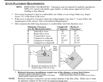

43" - yikes! This would be a corner install. Looking at the 520 manual (p. 7), I'm seeing 18-1/2" reduced clearance for "Connector to Corner Wall" if using Duravent DVL pipe. I assume that applies to the chimney clearance all the way from the top of the stove up to the ceiling box, right? I actually may not have that -- need to check.

This is what I see in the manual, if I am indeed looking at the correct manual:
(EDIT: I took a look at the specs in the seller's image of the stove's plaque and they match the ones in the manual image below.)

Yes, I like the stove and I’m tempted to go for it. However, that 18-1/2” clearance spec from the pipe to the corner wall (Measure F in the image above) could be a deal killer. I don’t understand why 18” would be required given that Duravent DVL pipe only requires 6” clearance. I’m still trying to figure that out.
The picture helps a lot. My manual is for the 1983 M520. By 1992 the stove was called the 520-96. It had 2 secondary tubes by then. In 1994 the newer model started being called the Liberty with 3 secondary tubes. I'm surprised it was still also carrying the 520 designation. My guess is that the NT model designation was for "new tech".
Back then the tubes were not stainless steel and burnt out after several seasons. The replacement tubes are stainless and long lasting.
The stove is highly radiant so the side corners need good clearance. In this case that is dimension 'C' or 7" with the rear heat shield on the stove.
