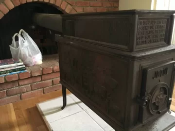

~ unknown stove ~

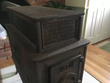

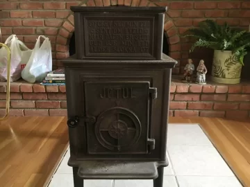

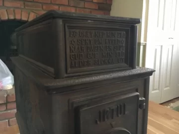

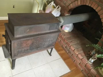

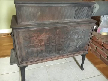

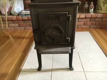

It's a Jotul F118. This is not ideally setup. Galvanized pipe should not be used for stove pipe and the hearthpad needs centering. The stove and hearthpad could be moved all the way back until the legs touch the fireplace hearth. If the galvanized pipe continues up the chimney that is a real no no.
