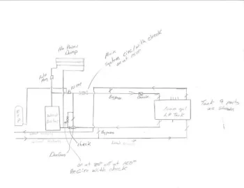

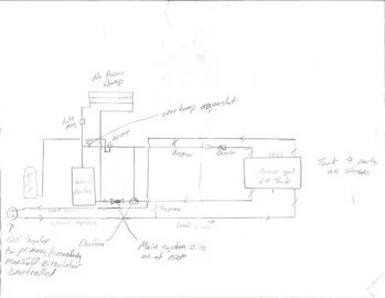

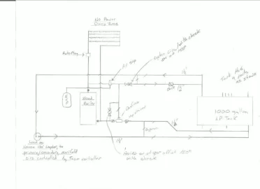

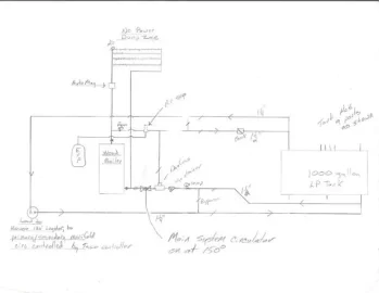

I have attached two drawings for my econoburn with 1000 gallon lp tank for storage.
One uses the same ports for charging/load and boiler return/ Load return.
The other one uses one end of the tank for boiler and the other for the load.
I am not sure where to put the econoburn recirc, I think I can delete it but the controls will have to be altered. I purchased a Danfoss for return protection. I am going get the boiler going and then add the storage, So I am adding valves to bypass the tank.
thanks
