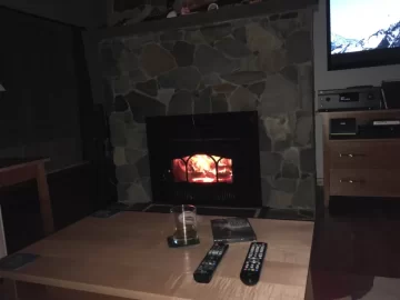

I’m kinda fond of this Rockland.
[Hearth.com] Upgrade advice desired
