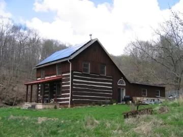

We live in an OLD 1800's log cabin/farmhouse. It is about 1800 SF, with spotty insulation. I do what I can to improve it when I see an opportunity. It is about 20X24 two story in the front, with a single story addition in the back, flat roof (or close to it, 1/12 or 2/12 pitch). The stove sits in this addition area. Chimney is straight through the roof, fairly open floor plan. The flat roof area is (from what I can tell)is not much better than R-19, grossly inadequate. I can feel cold air coming from around the top plate in that part of the house.
Our logs are 12x12 (or larger) poplar, chestnut, and oak; dovetail corners with 1" to 10" chink joints with various degrees of insulation between. The roof in the cabin is underinsulated, but better than the back part. It's home, though. The mansfield is just right...
Love it! Rockin' the PV array on top of the 1800's log cabin :)
