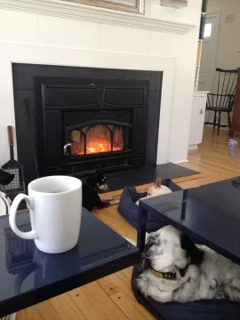

Have a Jotul Rockland 550 insert approximate 2.2 cubic foot firebox (24” w x 11.5” D x 14” H) in a center chimney with block off plate. It is rated at around 1,800 square feet which it does quite admirably. However I am in an approximate 2,500 square foot house and when the temperature drops below 30 the stove really struggles to keep up. Normally I kick the furnace on in the morning and again once or twice further throughout the day to keep the stove room temperature in the high 60’s very low 70’s. The rest of the house varies between 5-10 degrees cooler.

Background - 2,500 square foot cape with recent blown in cellulose insulation and 80% of the windows are 2-3 years old. Fairly open plan with master bedroom on first floor, kids bedrooms are on second floor but currently in college. The chimney is in the center of house (inside wall - only top 4 feet of chimney is exposed to elements) right next to stair case. Heat distribution works out very well but just lacking the extra BTU's when the temps get to below 30.
Example - Last night was running the stove all out getting stove top temps nearing 700, stove room 72, kitchen and dinning room 71 (which are open to stove room). Bedroom was probably mid 60's. I push the heat around with the inserts fan and another small fan in the hallway pointing toward stove.

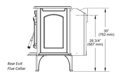

Since my fireplace opening height (Lintel) is exactly 30" would I be able to use the Jotul F55, Quadrafire Isle Royale or Hearthstone Manchester which are all exactly 30" based on manual? Would it be tight but fit? Not sure if the pipping that goes into that rear exit would be slightly larger?

Secondly really like that the that the F55 which offers ember protection only, this would allow for a slate hearth (which we currently have but would need to be replaced/extended)
Otherwise The Woodstock PH or IS offers shorter leg kits. Jotul Oslo offers same short leg feature but only 2.5 cubic foot firebox (which would not be worth trouble to me
