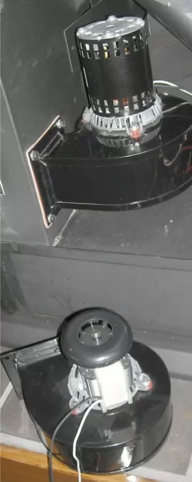

So this is the US Stove Fix!
The new replacement convection blower under the warranty does NOT have any rattling case and is much better balanced.
See original blower in stove and new replacement blower below it.
Both blowers are made by Fasco!

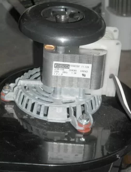

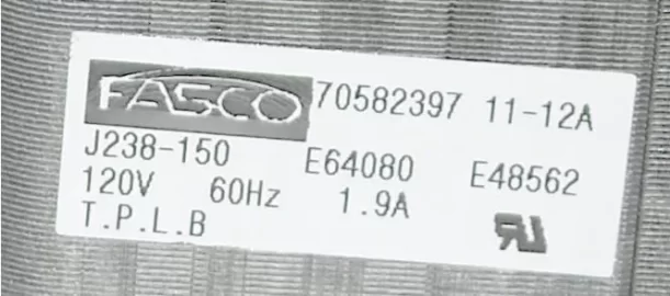

New US Stove Replacement Warranty Fasco Convection Blower Specs
Fasco 70582397 11-12A
J238-150 E64080 E48562
120v 60Hz. 1.9a
T.P.L.B.
