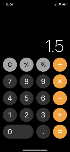

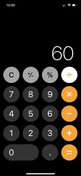

Therefore Auger Speed when plugged into an AC outlet is 60/40 = 1.5 Revolutions Per Minute

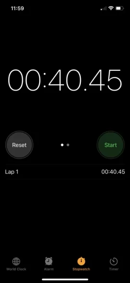

In this video you can also use your stop watch timer and see One Revolution is approximately 40 seconds
Note: in the picture of my stop watch timer below, I did not stop the timer as soon as the motor shaft finished one rotation, that is why it reads 3/4 of a second faster that 40 seconds
