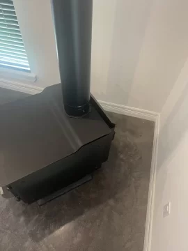

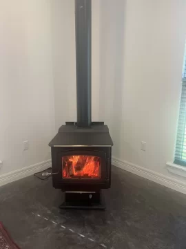

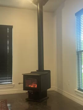

I installed my stove with the 18” to combustible material and after the fire has been going for awhile I am noticing the gypsum with drywall mud seems to be getting warm.
I made sure the corners were 18” as the diagram listed on the installation manual.
Should I be concerned and install some form of backer with tile/brick, or is it ok?
I took a thermometer and the highest temp I am getting on the wall is 120.4 degrees F.

This is a radiant and unshielded stove. 120ºF is ok and not untypical. If the wall temp stays below 160º it is safe.
I don't see a hearth pad. What is the floor material and construction?

The floor is stained concrete. It is slab on grade.

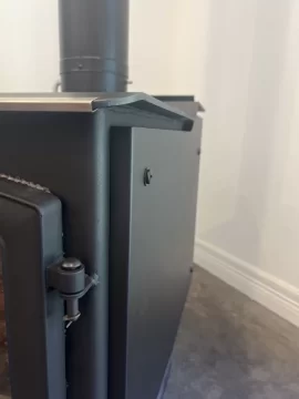

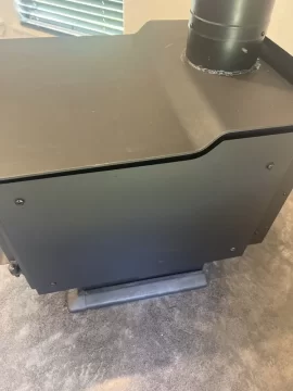

A radiant stove radiates heat in a straight line, like the sun, until it hits a barrier, like a wall, or furniture, or your body. Many modern stoves have side panels, spaced 1/2" from the stove sides. These dramatically reduce the heat radiated from the sides of the stove. The panels are usually open at the bottom and top so that heat can naturally convect upward. They also dramatically reduce corner clearances to as little as 3" depending on the stove design. The convective design also helps circulate the air in the room.

I thought that might be stained concrete. Looks good.

So this is not a shield? Sorry I’m learning and I really appreciate your help. Sorry for the stupid questions.
Not a stupid question. Yes, sorry. It sure looks like it. The last US stove I saw was unshielded. I'm surprised it has such wide clearances with side shielding. Which model is this? Looks like it may be the Ashley AW3000E? Is the stove pipe single or double wall?

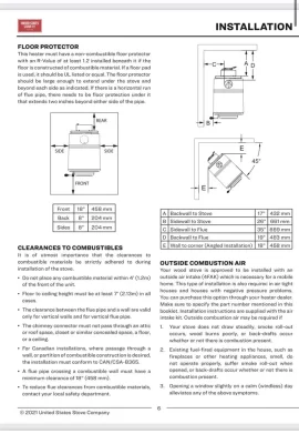

Just a guess, but now that I have the manual I note that there is only one corner clearance table for the Ashley AW3000E. Single-wall stovepipe has an 18" clearance requirement. Maybe they did not have it lab-tested for double-wall stovepipe. If they did, I suspect the corner clearance would be much lower.

Not a stupid question. Yes, sorry. It sure looks like it. The last US stove I saw was unshielded. I'm surprised it has such wide clearances with side shielding. Which model is this? Is the stove pipe single or double wall?
It is a vogelzang but it is manufactured by Us Stove. The model number is:
Model# VG3200-P​
The shields are still hot to the touch im showing about 165 degrees.
But the top is usually 250 plus so I guess they are working.
