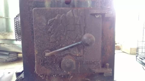

I also took a closer look at the stove, and though I know the previous owner used it to burn wood I wonder if it was actually designed for coal. Here's a bad picture of its face. You can't see it here, but it vents out of the right side in the upper corner.

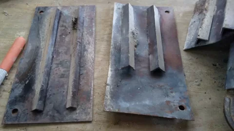

I also pulled these heat shields out of it. They're pretty warped.

I have yet to take off the top - the screws are pretty rusted - but it hasn't been cleaned in quite a while, and I've already found the remains of several birds in it.
Thanks again for any thoughts about the viability of this thing.
