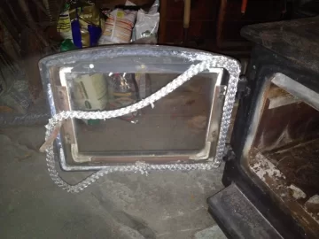

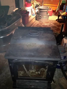

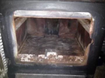

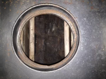

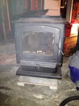

Hi All,
I've been lurking on the forums now for probably 6-8 weeks and I'm very grateful for the all the knowledge I've obtained so far. This is the first time we're trying to heat with wood this winter in Maine. Otherwise it's oil for us. I bought an Englander NC 13 used from craiglist. Great little stove but I need more. I don't have the money to buy new.
There is a used NC-30 about an hour and fifteen minute drive from me. It was made in 2007 but the stove has not been used in the last 2 years and is sitting in the guys garage. He wants $400 for it I'm hoping I can get him down to $300 as it needs at least one ceramic fiber board (maybe two) and a new gasket.I've posted some pics. I don't care about the cosmetics as it's a basement stove. I welcome any input from the more experienced and knowledgeable forum members. Thanks so much.
Bob from Maine

It's been overfired and abused to be in that shape already. Are the tubes sagging or cracked? Looks like it needs new baffles, gaskets and fire brick at a minimum. Personally I'd pass, but that's just me.
Does it have the bricks?
Check for warps in the door, burn tubes, and exterior framework. It doesn't look too bad. Try for $300, especially if you need bricks.
It's been overfired and abused to be in that shape already. Are the tubes sagging or cracked? Looks like it needs new baffles, gaskets and fire brick at a minimum. Personally I'd pass.
I don't see where it has been overfired.
It seems a bit pricey for me. Consider the fact you can get them for $1000 at clearance prices (around here anyway)....
Andrew
If he can get it for $300, and nothing is warped on it, that is a pretty significant difference from $1,000.
Agreed.
However since I have no time to paint/change gaskets, etc.....it just seems that it was a big neglected for only 6-7 years old (cosmetically)...so I would think it may have been overfired but could be wrong.
That paint didn't peel on the top in front of the step from any stewpot. That stove has had the crap fired out of it without one or more of the baffle boards in it. I bet it glowed real pretty.
I looked at that and thought rust/moisture/chitty storage.
But, I can't argue that it could be from overfire.
The owner probably posted on here about how he couldn't get a decent fire to stay going... convinced it wasn't his wood he burned it with the door open most of the time, got tired of it and took it out to the garage.
I'd say be very careful to make sure you are really getting a deal... Tough time to be shopping for stove though.

Wow....such speedy replies. Thanks guys. Yeah, I thought this stove looked pretty beat up. I didn't even realize the bricks weren't in it from the pics. Thought they were just really dirty but looking more closely they obviously aren't there. How do I tell if the stove is warped?
I wouldn't bother to check it for warping. I'd pass on it and keep looking. Rick
I wouldnt bother with that. Just got my NC-30 from Home Depot and love it. Heats my whole house and a beautiful door to see the flame. No issues whatsoever. Id pass on that and go grab one at Home Depot. Check out my avatar to see that baby burn beautiful
the stove has been over fired, the white in the paint is the indicator (trust me I know what to look for) definitely aren't any bricks in it, honestly though the top if its not bowed can take that as long as its not repeated a bunch of times. I agree it looks like it was burnt with the baffles misplaced or at least partially missing. still by the time you get the stuff that's missing (freight on bricks sucks) you wont be too far from what you might be able to get a new one for.

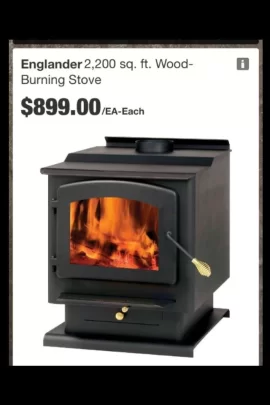

Home Depot's website has it listed for $899 as of now. Id rather pay $899 and walk out of the store with a brand new, unblemised stove bought from a reputable superstore than get a blemished stove purchased from a smaller company and have to worry about shipping. Thats just my opinion that doesnt really matter anyway.
