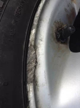

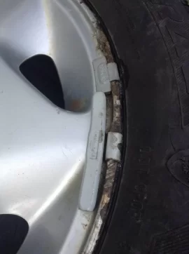

Here are some shots of the damage I'm talking about. Appears the wheel was balanced after the fact, so perhaps it was a non-issue then.

Feel free to smooth those rough spots out if you are so inclined. When you put the new tires on, it will all balance out with weights.

I don't see anything to worry about with the ones in the pics above. You could spend some time with them, in between having the old tires taken off & new ones put on, cleaning up the rough spots if you wanted. A sanding disk in a cordless drill, plus some hand sanding and a splash of close-matched spray bomb paint would stop things from digressing. It's mostly about the looks though.
