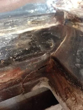

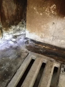

Examine the stove overall for any cracks and in particular look closely around the interior grate and base. Also carefully examine the secondary manifold for any sagging or baffle warpage.
Here is what you are looking for at the inside of the base:
View attachment 118702 View attachment 118703
