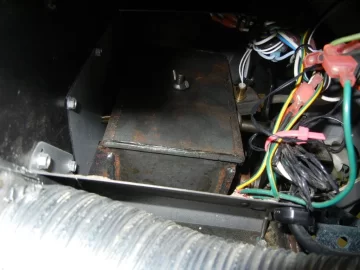

fines box? not sure what that is,i own a p38+ does that have one?flame gaurd that is the removable piece above the burnpot correct? here is a photo of it,ad says p61(broken image removed) (broken image removed)
Yes, all Harman's have a fines box, located back left side of stove, has a wing nut to hold cover-plate on.
Reactions: topcat11866
[Hearth.com] used stove harman p61 Fines box, its over the room fan.
