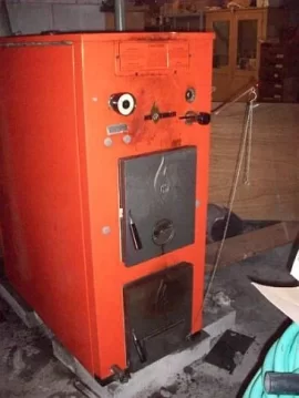

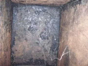

The fire box is about 27" from door to rear. I took a couple pictures of the unit. MB75?? how many BTUS if it is?

MB55 probably.
You should be able to get a manual for it from Tarm. That is a very capable boiler, the 55 is probably the KW rating, which would be like over 175,000 BTU maximum.
The 8" pipe would go over the flue collar, not within it, so that might solve that problem - along with some furnace cement.
As far as burning clean....well, let me explain it this way. It probably beats most other natural draft water-based (wet leg) boiler out there, but not nearly as good as the new technology. It COULD be burned clean, but only when used relatively heavily......with a good chimney and good wood. If someone was setting this up with a decent storage system, it might perform well....but unless you have a drafty farmhouse it might be too much boiler.
