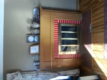

Probably best to post a picture of your fireplace here to start.

I will try to get a picture of my existing fireplace posted. I do realize I will have to do some modifications to the area to meet some clearance codes.

Here is a photo of my fireplace. The opening is 30" h x 36" w at the front and 27" h x 27" w at the back. It is 22" deep at the bottom and 18" deep at the top.

Check your clearances on the sides and top, it doesn't look good to me.....

Ram 1500, when you say check clearances are you talking about at the face of the fireplace where the wood mantle is or the distance from where the insert would sit in the existing fire box to the brick at the back?

From your picture, it looks like you have 6 inches on top and both sides, so you need to keep that in consideration with your project.....
