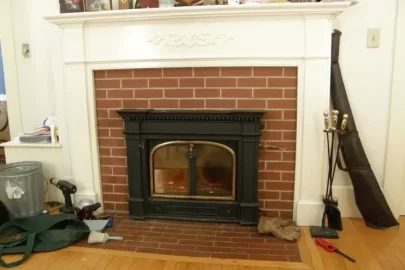

Just bought a Vermont Castings model 46 off of craigslist. Installed into fireplace and found seals were bad, so going through the process of replacing seals right now (could not adjust the dampener for secondary burn process). I am hopping the seals were the problem of insert not heating up. There was nothing warped or cracked in stove and newer blower was installed on insert before I had purchased off of seller. If anyone many have additional info on this insert, it would be of great value to me, starting fire, controls, seals, how to get insert hot enough to heat room, ect. Thanks

Must be one like this one?

Any problems with the bottom grate interfering with the doors opening and closing? Not uncommon, I can walk you through a fix... worked for me anyway.
