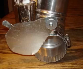

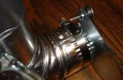

Here is a quick and dirty way to have control of the secondary air intake that anyone can build in about 10 mins. You can adjust the compression of the spring and the friction of the plate as needed. If the spring is not stiff enough, then the plate will not stay open. If the spring ever fails, then the sheet metal will cover the opening (safty feature). And its really cheap. Hope this helps!
1 aluminum 3" elbow
1 machine screw
1 nut
1 big washer
1 little washer
fairly stiff spring
hose clamp
90 deg bracket
piece of sheet metal cut to size

sweet!! now i have a list of what i need to buy this weekend!!
wonder how a coat of black stove paint would hold up on that?
Not sure how well the paint would stick. You can also get 3" elbows in galvanized steel. Just make sure you de-grease it well and paint should stick. Also, I am upgrading the design by replacing the rear hex nut with a wing nut and lockwasher. I think it will hold a bit better and be easier to adjust. Good luck!
