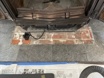

It looks like they tiled after it was installed, and the ash lip is jammed in there. I've got the montpelier. My stove sits down a bit inside the fireplace. When I want to remove the blowers, I have to use a small crowbar, grab a corner of the stove on either side, hike it up a bit and put shims under the leveling bolts. From the pic it looks like you're able to take off those 2 side panels. Any access there? Maybe take the surround off (heavy, but should lift off), and try to rock the top of the stove into the fire place? You wont need much. Another person can stick some shims underneath. Perhaps (again, surround off) you can just push the whole unit into the fireplace a bit to give relief. There's usually some play.
Take a look at the manual. It doesn't mention removing the ash lip, but it does talk to mounting everything during the installation. Maybe that'll help.

Thank you for the idea! Yes they tiled after it was installed. I’m guessing the blower has never been cleaned - from what we can see.
mociun
Feb 14, 2023
16
California
I’m afraid the slate will need to be removed. I see no other way to access the blower assembly - sad to say.

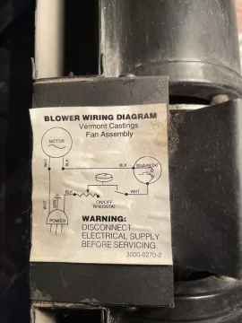

Here’s the vermont castings blower wiring diagram for merrimack and Montpelier inserts. Conveniently located on the back of the blower. 😑

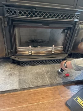

It was an absolute mess… we made a tent for the slate cutting. Used a handheld cutter with a diamond. Then chiseled out the 6 pieces of cut slate.

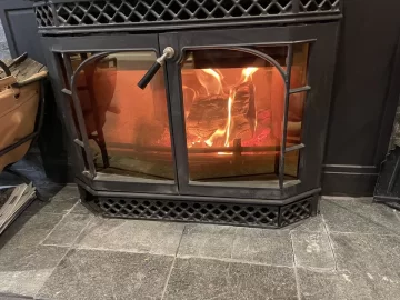

And now, a fire, a blower, a warm evening inside - a cold and chilly night outside…
The rheostat was fried. I bought a new rheostat and snapstat from Mountain View Hearth Products in Columbia Falls, MT (406-272-9850). Remodeled the slate and cleaned and replaced parts.

The fan was very dirty. The prior owners also routed the electrical cord in such a way that it cannot be removed without removing the façade from the fireplace. 😑
I worked with a short cord. But the good news is the fan works!
