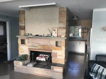

Got it, great explaining that. So seems to be drawing air in for somewhere. The photo of the fireplace up stairs (first floor) has a metal lip on top that I installed to help keep the smoke in the firebox, was leaking out and filling up the room. That lip that’s painted gold , part of the new metal roof I put on did not work and will come off. What did work was opening up a window, darn smoke stain on the stone above is as [Hearth.com] VC Resolute 1979 (III?) clean as I can get. Wire brush is what I used. Since there is no 6” flex pipe running up the 13X13” flue the back of the fireplace flue is nice and warm. This is the back of the upstairs fireplace.

Got it, great explaining that. So seems to be drawing air in for somewhere. The photo of the fireplace up stairs (first floor) has a metal lip on top that I installed to help keep the smoke in the firebox, was leaking out and filling up the room. That lip that’s painted gold , part of the new metal roof I put on did not work and will come off. What did work was opening up a window, darn smoke stain on the stone above is as View attachment 243047 clean as I can get. Wire brush is what I used. Since there is no 6” flex pipe running up the 13X13” flue the back of the fireplace flue is nice and warm. This is the back of the upstairs fireplace.
