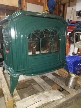

So I just went through this.
Guy wanted $500 for stove, I saw combustion chamber was garbage, got it for free.
Replaced combustion chamber , gaskets and 1 warped grate for about $360. 3 hours labor, and one snapped screw in the flue plate which I chose not to drill out. $5000 stove for $360, and I was just burning at 600 degrees and heated my whole house. I can walk you through the basics if interested.
  • [Hearth.com] VC Resolute Acclaim 2490 - How to Replace Combustion Package
