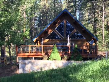

I wish to place my pellet stove in a corner. I have a 12/12 pitch metal roof and experience fairly heave snow loads. I am reluctant to have my venting be on the lower end of the roof for multiple reasons. Primarily for aesthetic reasons I do not want a 4-6 foot pipe extended out of the roof, and due to snow load it would require a snow/ice diverter (cricket) and supper for that length of pipe. What I wish to do if possible is vent outside to the front of my log home and have the pipe bend and follow the roof line under the log purlins and then bend vertical to push through the ceiling. This would allow for the pipe to vent high on the roof with less snow load issues and hopefully reduce the length of the pipe on the roof. I am considering also running the pipe (black)exposed on the inside of the home suspended from th log purlins as an option as well. I hope the pictures give an idea of what I am wanting to do if it is possible. I the picture outside the home, the stove would be located in the right hand corner, the inside view would be the left hand corner after removal of the zero vent propane heater that is in place now. Thank you for your input of the feasibility of the install.

Thank you for the attachment and advice. I am justifiably concerned about pushing out thru the wall as it is log. These so called "wall thimble" push thru options are not very aesthetic and that is of importance. However it may become my only option as so far HVAC installers want to do the quick easy thru the wall installations and do not want to go thru the roof. Not like there would be another option if I were to do a wood stove instead of a pellet. I understand now that draft length above the roof is not an issue but if I can't find anyone willing and able to do that for me then thru the wall is my only option. I must wish there was a kit designed around a log home install that looked good.

The only other way to do it aside from roof or cutting into a log would be to sacrifice a window by framing it in and putting the thimble through the frame
So honestly, the thimble can't look worse than the satellite sitting there (my opinion only). The thimble is small enough, and the nature of log cabin lines, as well as your beautiful windows and deck, that after a few days, you won't even notice it being there unless you are really looking for it.
You can buy thimbles in black or you can paint the thimble with high temp paint I painted the exterior side of mine hunter green while the inside is black.
