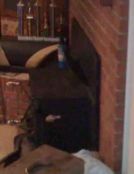

I am looking for some suggestions on venting my old Fisher wood burning insert. Back in the gas crunch time of the seventies my father bought 2 wood burning inserts for our fire places. Both had a blower/hot air exhaust on them and they where vented out by the homes chimney. Over time the chimneys built up a volatile amount of creosote and voila my parents had your proverbial chimney fire. After the fire dep. extinguished the flames my father decided to have the chimney inspected and guess what? The subsequent chimney inspection video showed cracks all over on the level of the fire on the second floor . I know that these cracks are dangerous for letting heat and exhaust fumes wiggle there way into various parts of the home along the chimney, but I would still like to use the fire place in our basement. (see photo of basement fire place)

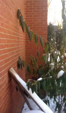

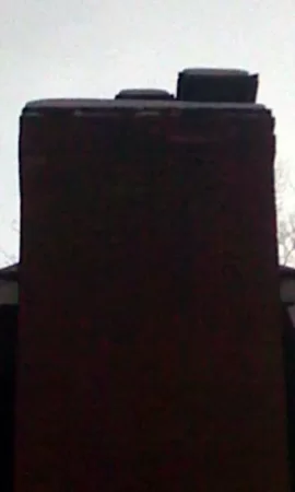

Thanks for you all your time. And take a look at some of the pics I sent they show the outside of the chimney and just above the ground where if possible I would like to come out with the new flue.
