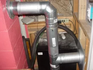

I have a Clay Lined Cinder Block Chimney and that works fine.
see pic
  • [Hearth.com] Venting into brick chimney?
