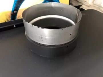

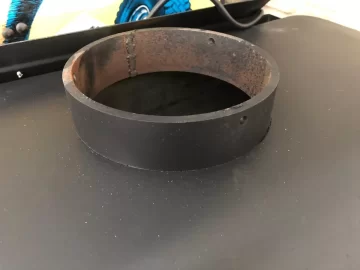

Can the flex vent connect directly to the stove or should I plan to use the SS connector? I would think using the connector would be easier anyway since it's a clean ring and gives me a little more play to fit it in place. Should I only secure the connections (with 3 sheet metal screws or should these connections be sealed with a high temp sealer/silicone?
[Hearth.com] Venting wood stove into existing masonry chimney [Hearth.com] Venting wood stove into existing masonry chimney
You will want to use an appliance adapter meant for flex liner. These have a large band clamp to secure the liner. This is much better than screwing into the thin metal. They come in straight vertical adapter or small angle elbows (15º & 30º).
Thanks! The stainless connector that was in my picture is the appliance connector that came with the flex liner which did come with a couple of band clamps. That said, I will band clamp the flex liner to the vertical appliance adapter in my picture, then I will screw the appliance adapter to the stove, is that correct? As you can see from my picture, the stove is about 1/4" thick steel so I wouldn't be able to use a band clamp there, I would only be able to screw it in. Should I use foil tape around the seams to ensure that it's all sealed up?
