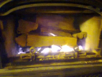

Its going to be cold tonight... sorry for the crappy pic from my cell phone. This is my overnight load [Hearth.com] vermont casting montpelier

thanks for the picture. the wood your using looks pretty beefy not skinny logs
how long wiil that last
thanks Tom
Most of those are the 9" x 4" blocks I mentioned. Most are a bit too long for a north south load, so I try to fit them in however I can. The load winds up less densely packed than I would like, and the burn time is shorter. There wasn't much left of that load in the morning. Probably down to the coaling stage after only 2 1/2 hours or so.
