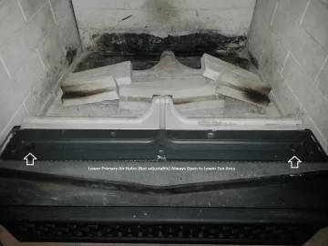

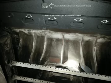

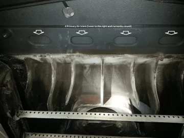

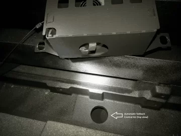

    Couple of things....
    Put a watt meter on the fan outlet. The fans draw 150-155 Watts at full speed.
    Here's some pictures of the primary air top, bottom and autosetback air.
    View from top after removing auto-setback control:
    View of lower air intake after removing refractory brick. These inlets are not adjustable:
    Primary air top inlets with glass wash deflector removed:
    View of top Primary air inlets in open position:

    Great pictures, thank you. There is a lot of information with them. I just had a Merrimack installed last night. I'm almost done with the preliminary burns and will posts pictures when I'm doing full burns.

    Thanks you everyone. My automatic setback air control box was not fully seated down against the top of the stove. I had about a 1/8-1/4 gap and you could hear the "whistle" even with the setback device flapper closed. I would say this is a very important "feature" for every stove owner to inspect - I am looking forward to the difference in burntime and blower exit air temp with the air leak now corrected.

    How did you check to see if the gap in the automatic setback air control was seated properly? It sounds like a good thing to check.

    I found it, it was easy to see when the door was open! It is seated properly but did not stay open when I checked it when the stove was cool and I pulled the automatic setback control to the left. I'm pretty sure it should stay open when cool, until the stove is up to operating temperature, right?
