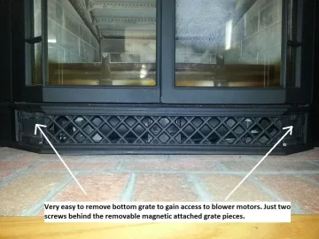

    Those two phillips head screws (behind each magnetic door) that hold on the lower grate do come from the factory fairly tight.
    For others.....make sure you use a good sized Phillips screwdriver to fit the head properly.
    Stripping those heads is not an option and would really stink.
    I take my lower grate off every month or so to give the fans a good vacuum cleaning.
    Other than that...the blower assembly is simple to remove/replace.

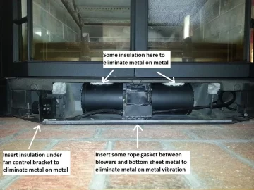

    My Merrimack had a March 2012 date on it. I don't know if VC ever did anything to quiet the fans or not.
    I did not have the LOUD fans that others have mentioned, but I would get a vibration from them when the stove got real hot.
    In my case, it was a very easy fix. I just added some door gasket under the blower assembly and some insulation tucked in to some other metal on metal locations.
    I typically keep my fans on full blast and you can definitely hear them, but the stove room is also our TV/family room and it's fine.
    If I put the fans on 50% or lower, they are dang near silent.....especially with the TV on.
    Here's what I did to eliminate the vibration that would happen occasionally at high stove temps.

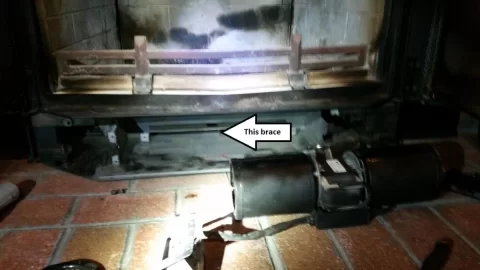

    I started getting the vibration/jackhammer sound from the fan and found the source.
    The sheetmetal that the blower mounts to is the culprit.
    In the picture below you can see the brace that vibrates against the sheetmetal floor.
    The brace is a punchout that swings down to support the ductwork.
    Since it is a punchout from above it simply rests on the sheetmetal floor.
    Stick something under it to eliminate the metal on metal and the vibration/jackhammer sound is gone.
    Hope this helps someone else. That noise was ridiculous.
