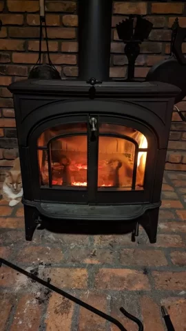

Hello Everyone. Im fairly new to burning, coming from an old 1978 Frontier Wood stove that was pretty easy to run. I just purchased a new VC Dauntless wood stove. I do not have the CAT installed because they are on back order right now. Last night I had the stove going and decided to load it up with about 5 pieces of wood, which almost filled it. After it heated up, I close the bypass ( which makes the fire sound like a blow torch for some reason). No smoke is coming out of the chimney. The stove top remains about 450 but the flue is heating fast, approaching 450 as well pretty quickly. I decide to damper it down a bit with the heat control, but the heat is still climbing. I waited a bit and gave it another turn lower on the heat control. It was still running hot and the stove top was still climbing. I turned down the heat a bit more slowly, until the flames began to calm down (im afraid of the stove overheating over 650). I noticed I could not see the flames much anymore and the glass on the door turned really smokey. I turned the heat one click hotter to give it some air, and BOOM. There was an explosion and the top loader door swung open and shut. Scared the crap out of me! I'm really nervous to run it again. Any thoughts on what happened?

You had the wood in the box ignite and flash over. The combustion created pressure in the firebox that pushed smoke out of the top. Seems many of us have VC puffers that do this. seems the box starving for air will pull it down the flue and cause the flashover. Mine did it this morning. My stove is 35 years old and it's done it since new, but mine has a cat and it only does it with the cat engaged.

You had unburnt volitiles waiting for air to ignite it. It got some air and ignited.

Is there a way to prevent that from happening ever again? Seem dangerous. Why would there be so much smoke build up and ignite like that?
It's a fine line between enough air to prevent that and not enough air that causes that. Others have had problems controlling temps with the bypass closed.
It could be dangerous in the extreme case. If nothing else, it is upsetting. Wet wood and/or weak draft can exacerbate this situation, especially when the air is suddenly opened to revive the fire while the firebox is full of smoke. I had this exact situation happen to me a long time ago with our Castine. I was trying to get a balky fire to start with some maple that had gotten wet in places. The fire started to smolder and I mistakenly opened up the ash pan door (don't do this!) to rush some air under the fire. That cause a flame to appear which ignited the firebox full of smoke. The resulting back puff was strong, sending smoke out of every orifice and pipe seam. Lesson learned and not repeated.
If the air is turned down too low so that the flame goes out and the wood begins to smolder and the cat activity is marginal or dead, then the wood gases will build up in the firebox. At that point, a new little flame or spark can ignite the wood gases and create a small to fairly large explosion called a back puff. A back puff can push smoke out of the intake, stovepipe seams, etc. The best thing to do is to keep a small flame by not turning down the air to the point where there is no flame. And only burn dry wood.
VC stoves can be temperamental in non-cat mode. There is a long history here. In the early days the NC stoves from VC earned the nickname of NeverBurn. There is a skill needed to make them burn will without the cat. This depends on dry wood and a decent draft. The jet noise you heard is the afterburner combusting the wood gases in the secondary burn chamber at the back of the stove. Note that 650º on the stovetop is ok, 800º would be a prudent limit.

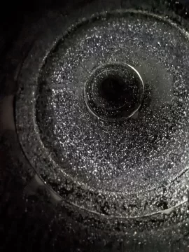

I have experienced all the same problems with my VC Dauntless (2nd burn season.) I've been burning wood for 45 yrs and have never had a more finicky stove than this. Steep learning curve. Still trying to reliably manage smouldering or overheat, black glass, flashback. I have yet to find a way to do a long burn without overheat or smoulder or flashback with thick carbon deposits on the glass. Small hot fires are fine, but require reload with two or three splits every hour or so. Have had no problem in the past with Jotul, older VC's, and my favorite, an Efel Montana that I replaced with the Dauntless for longer burns, more efficiency, and clean glass. Should have kept the Efel! (Chimney height/draft/dry wood, etc not an issue.) It's a nice looking stove, but if I had it to do over....
I get black glass in the same spot every burn. It's a semi circle across the top. Pictures attached. Does yours do that too?

My glass get dirty in the same spots, also a little in the lower corners on the hinge side of both doors. The left door seems to get dirtier than the right for some reason, but never anything I can't wipe off with a wet paper towel and some ash.
Id recommend you point a flashlight in your flue and take a picture of it with your phone to check for creosote. These can be creosote monsters if you dont burn hot.
By running below 450 without the cat, Here's what I was able to produce with two 24 hour burns with a cold start in between (so about 8 hours of idle in between)...using the exact stove you have.
That's alarming, but this was done to test how truly bad the downdraft combustion is and how wasteful this stove can be, and because I had a creosote burn off (aka chimney fire) from many 10 days of usage. So now I try to keep my temps to a level that I feel confident and inspect as often as I can.

I've given up on cleaning the glass. The Dauntless bakes it on thick. A decent hot fire cleans it good enough.
