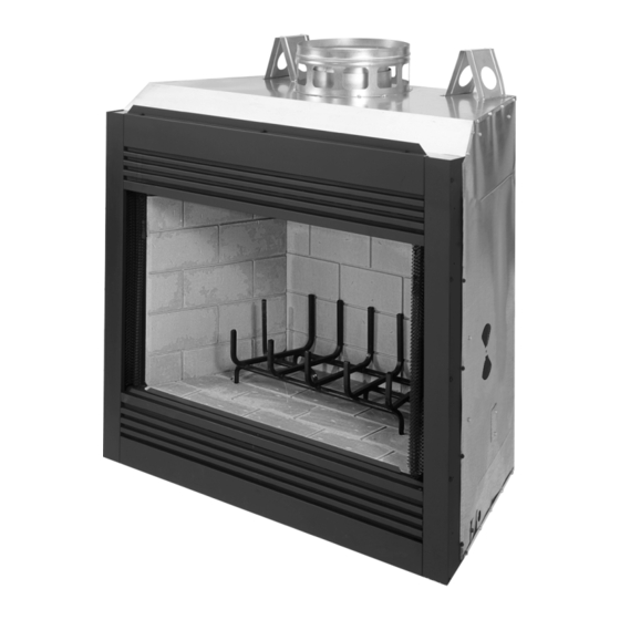

The house came with an older Lennox zero clearance fireplace that is pretty to look at but basically worthless as a heating appliance. I should note that the house is tight and well insulated and has a newish heat pump that keeps the place nice and warm, so we are not trying to heat the place with wood by any stretch. We wanted a wood burning insert for the ZC, but we found very limited options because of the relatively small fireplace opening, so we settled on a Vermont Castings Gifford because it was the only thing offered by any local stove sellers/installers that would fit.

The ZC is a Lennox HC 24, it came with the house and we received no documentation with it. The stove retailer/installer (Warner's in Cumberland MD) saw no issues with putting the VC Gifford in there, but they'll have to change out the stainless stove pipe that runs up the chimney.
Sorry, I am not finding anything pertaining to a HC 24. Did you mean the HC 42? If so, the fireplace can not have an insert installed unless it is specified by the manufacturer. This is from the manual:

This is the manual for the HC 42.
