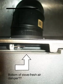

OK. I laid on the floor and found the "secondary air spot". I think. It was in the center back of the stove. It looks like it has a thermostat thing attached to a metal plate. The metal plate looks like it will go up and down. Right now the stove is cold and so it was all the way open. I guess I will have to make a fire to see if it closes up or not.
that's the picture I attached.

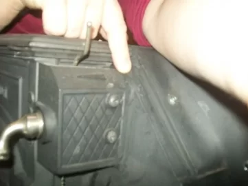

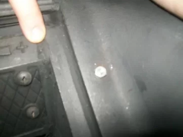

Alright, I think I found something!! I turned out all the lights and shined a flashlight around the seams. When I got around the top, near the + and -- skinny damper control, light was shinning in the firebox!!! This is when the CAT is off. there has to be a leak there!
So I am thinking, get some furnace cement and seal up that leaky place! Will try to get some after church tomorrow. Any special tips for doing it?

Hubby brought home tube of Rutland furnace cement. I put it anywhere I thought might need sealing and checked with a light again. Now I do not see any light. Letting it cure overnight and will try a fire tomorrow afternoon. I'll keep you posted. If I don't get it too hot, I'm going to slide the mirror under it and see if that air control in the center back makes any changes. I can't figure out how to test it without making a fire. Hope that works, getting tired of playing Nancy Drew detective!

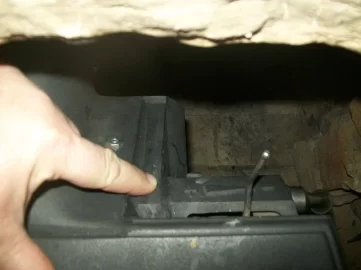

I think we found the problem!! Had 2 fires in the stove yesterday, and the one last night the stove worked pretty good. Had it putter along last evening, then it worked up to 650 degrees. I cut the draft/air flow switch and it worked!! The temp dropped and fire responded to lack of air.
I feel pretty comfortable saying it was the place near the thermostat where the caulking stuff came out. Probably because we have a long driveway that is gravel. Maybe the ride home was a little rough??
I tried to show some pics where I repaired it with furnace cement. It was a little tricky because I did not want to disconnect or move the stove. Used a mirror, a Popsicle stick and my hand to put it where it needed to be. Not the neatest job, but I was trying to fix not look pretty!

The gap you sealed shouldn't make any difference. That gap doesn't let any air into the firebox....that point would simply let air into the reversable flue collar area, which is outside both the firebox and the refractory chamber area. In any event, the rod from the damper handle passes through underneath where you sealed and is going to let some amount of air into the exhaust stream anyway.
The secondary air flapper you photographed should be open when the stove is cold, and closes down as the stove heats up. It is connected to a bimetallic thermostat and metal probe that sticks into the refractory chamber/exhaust stream immediately after the catalyst. As long as the flapper is still hanging by the metal rod from the bimetallic coil (and assuming the probe hasn't eroded away over the years) you should be OK with that aspect of the stove.
If you still have temp issues, make sure the damper gasket is intact and that the damper door seals securely when you turn the handle up.

I also put some furnace cement along the edge where the reversible flue collar was on 3 sides. Not very heavy. We did flip the flue collar, but the gasket seemed fine. Just standing there with the furnace cement and just kept going with it.
When I looked inside the stove, I could see light on the top back of it. that's why I put the furnace cement there. After we put the furnace cement there, no light leaks. I still want to get some of the incense sticks to try to go around it more and look for leaks. Just haven't been to town yet to go to the store. It's about 15 miles to a big enough store to get them. with the price of gas, no frivolous trips. Has to be a combined effort.
