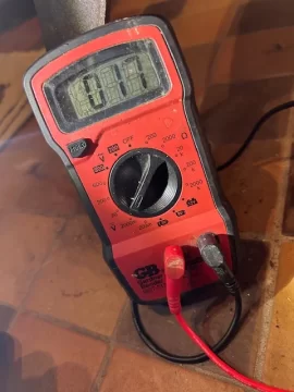

A question for you, Daksy - though I have a multimeter I am not familiar with its settings - which VDC setting should I set the meter at? I see 200m and 2000m and then 20, 200, 600.
My guess is probably the 200m setting? 'm' for milivolts?
The readings on the meter rose as the pilot heated up - the readings stayed constant after the burner was lit - when the burner and pilot shut off the readings started to drop.

With meter set to 2000m I get a steady reading of 257+/- but here's something odd - anticipating that some disassembly was coming I removed all the "logs" - and restarted the flame - it isn't shutting down now.

Hi, Bob - thanks for your patience - fired up the fireplace - meter reading was 237, slowly rose to about 252.
When fireplace shut off the readings dropped rapidly. Should I order a new thermopile?

Hi - yes, probes are on TP TP-TH trerminals. Only doing one reading - stove is started up with knob on front of stove. It ran for about 5-8 minutes, shut itself off. Reading started dropping rapidly from 252 +/- to zero. Probes in contact the whole time.
