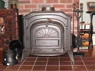

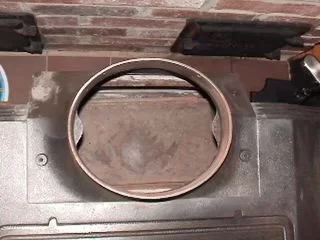

My wife and I recently acquired an older v.c. resolute, and I am having trouble figuring out the size pipe to use. Opening is 6 1/2" by 5 1/2", and I'm wondering if it is meant for an oval to round pipe, or if the 6" is just pressed out of shape to go in? I would like to use 7" pipe, if possible. Any help or instructions would be appreciated.

That looks just like our VC Resolute from many years ago. Great stove. Is it in as nice shape inside as it is outside?
The stove has a somewhat oval 6" round collar. You could try 7" pipe in there, but that's a bit of an odd size. 6" round is much more common.
It's in pretty good shape inside. I wire brushed the outside so my wife could paint it, but I like it the way it is now. I reminded her that if she paints it, she will have to maintain that forever... Yea, 7" just slips over the collar, so I would need an increaser, but I would be fine with 6" if it will draw o.k. and can be made to fit into the oval.

Correct, BG - of course. That is a old resi. Not an acclaim.
IN fact, it is the first or second version of the Acclaim, probably 1979-83 vintage - because of the drop down door. The next version had two swinging doors, and then the Acclaim followed that.
Definitely uses a 6" pipe. We should have the manual for that stove in the wiki.
https://www.hearth.com/econtent/index.php/wiki/Vermont_Castings_Older_Stove_Models/
Yes, it looks like a generation I Resolute. Ours had the dropdown door, no glass. I only used the front door for cleaning. It's a great, simple stove that heats very well. I still like the thermostatic damper it had. Tip - put a tiny magnet on the edge of the damper. That will make it close positively. Otherwise, when the air requirement is neutral, you'll hear it go tap tap tap as it hits the stove body. No big deal, but the magnet makes it's operation more elegant.
Thank you one & all ! Craig, after you said it was Definitely 6", I went down to the hardware store and got the pipe needed. 30 minutes later, I'm heating with wood again! Just in time, as it's raining pretty hard here now. What is the best way to idle the stove down when we go to bed? I'd like to keep the area heated, but I want to use the wood efficiently. B.G - Thanks for the tip with the magnet, I took one off the reefer and put it on there.
