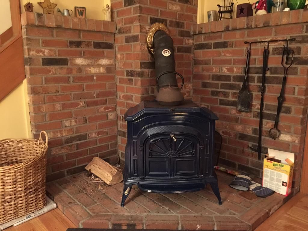

This is my wood stove. Up close it's a little rusty, and definitely has age to it. But, as far as I can tell, it doesn't leak anywhere or anything like that. Not sure what to do, or what I am doing wrong.

The bypass damper is the lever on the left rear side of the stove.
[Hearth.com] Vermont Castings Resolute III Issues
It has two positions. One position (up mode?) allows flue gases to go right up the flue from the fire box. Use this mode to start fires and warm up the stove. The second position is the horiz. mode. In this mode the flue gases are forced to go down and through a secondary burn chamber before exiting the flue. Note that there is a little flapper door on the lower left side. Leave that open, it admits secondary air to the fire.
Experiment with the bypass with the stove out while the top lid is open. You will see it diverting the smoke path in one position, but not the other.
