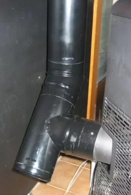

When you install the pipe put the T at a 45 degree angle and a 45 degree elbow on top of the t which will bring you back to the point of going straight up then you can get your brush in and wont be on top of the hearth pad
Exactly what I did:
