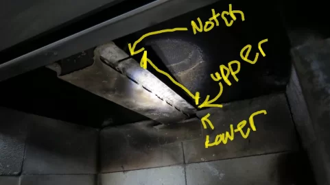

okay so I think I just figured it out, but I need some help from others. I need to know where the baffles go. When our stove was installed the baffles rested on the outsides and on the bottom piece of angle iron on the back of the stove. But I am looking at it and guessing it goes up on the next lip that runs the length from from to back just above the secondaries. Because that allows the baffles to be pushed back further. Well let me know.

I don't own this stove but would be the baffle needs to be above the secondary burns tubes. Are you saying it was below them before?
The baffle doesn't line up below them just right next to them, Which still allows them to work. The part that got me wondering was a notch out of the angle above the baffles towards the front. I don't see any purpose for it but when the baffle are put up where I think they go the notch lines up with the front of the baffles perfectly. Otherwise when the baffle sits on the bottom angle if comes almost right to the front of the secondaries bar.
Also note when on the lower angle the baffles sit angled and not flat on top. But when put up they sit flat (level with the floor)

Definitely.
According to the manual you want to pull the front left and right #3 bricks. Then
Carefully pivot the fibre baffle up onto the top of the side brick. Slide it over onto the flange of the manifold.
Ensure that the top baffles are pushed all the way to the rear of the firebox, leaving a minimum of a 1”
gap along the front. This will allow the flue gases to escape the firebox.
Definitely.
Yep I am pretty sure then that is how it is suppose to be. If any napoleon users could let me know where theirs sit that would be great. so now that I am going to have a gap in the front now instead of a crack the smoke should be drawn up better. Awesome, problem solved I think. My next question though is if I essentially had a dampening effect from the baffles being in the wrong position are my fires going to burn hotter with it where it should be. I ask cause last night I got a 13 hr. burn and had coals still hot enough to light splits this morning. This was with the air control shut down all the way. So am I gonna loose my ability to get such long burn times?
With the stove functioning correctly you will probably lose some burn time, but you will gain heat from the stove. Your chimney should stay cleaner also.
My baffles are resting on to of the manifold shield. I think the lower angle is used primarily to keep the top bricks in position. Perhaps the notch is approximately where the front of the baffles should be. I check once in a while to make sure that the baffles are pushed all the way to the back.
The main question is, will this help with the smoke spillage issue? I think so, but am waiting for results from makoda.
Sweet........problem solved. Just started a fire and it is a different stove completely. Well I guess we will see how it does as far as burn time but I think I am gonna loose a little on that. Hopefully not too much?!?!:eek: I have quite enjoyed coals being there in the morning.
